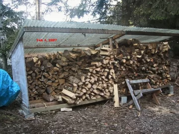

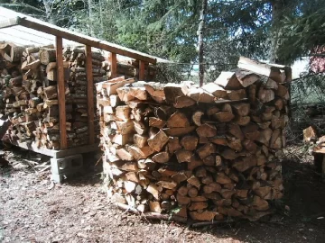

This shed lets the sun heat the wood, and allows the wind to blow through it. It hold about 3.5 cords.

I built a woodshed similar to the one WarmGuy posted pictures of earlier, approx 8'x16' footprint, 6' high on the back side, and 7' high on the front. The top I covered with the clear corrugated plastic "PAL" roofing - it was the cheapest "better than a tarp" alternative that I could find. The base was a frame of pressure treated 2X4's spaced to match my cut length, with 2 x 4 uprights on each corner and the centers of the 16' spans. There is are three 2x4's supporting the roof. The end walls are 6'x8' stockade fence sections. The side walls I leave open most of the time, but in the winter, I hang SILVER tarps from Harbor Freight from the top joists to keep the wood from getting covered with blowing snow or rain.
Harbor Freight makes tarps in three grades, blue, green, and silver. Blue is cheapest, silver is best, and is MUCH better quality - costs about 2x the HF blue, but is supposedly 4x the thickness, and made with ripstop threads, etc. I haven't done any scientific testing, but they silvers are visibly better than the blues I've gotten elsewhere, and the HF silvers are about the same price as the same size blues from the local hardware store.... I've also "munched" on one or two with the snowblower, and they showed amazingly little damage. Lastly, they aren't camo, but they don't show up the way the blues do so the neighbors may not complain about them as much.
This style of shed construction is a bit cheesy, but it looks OK, and is very low budget - I used almost no scrounged materials, but still only spent about $500 or so on building it.
