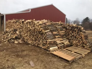

My almost current wood pile.
About 12 cord.

Yeah me as well. Nice stacks silverram.Must be nice to have a large area to work. I'm on a 50X100 lot including house and shed. Things get a bit tight.
