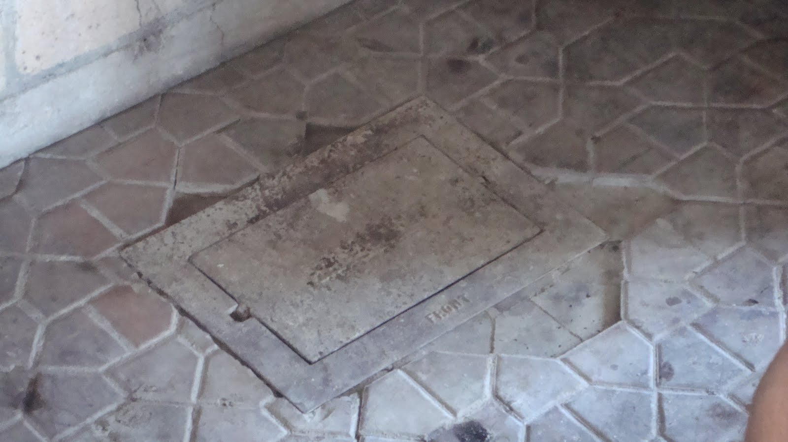

a quick browse around the web, and this is a similar looking item. it is on the floor of the fire place area.
[Hearth.com] How do you know if you need an OAK?
So, what do you think? Can i get away with rigging some kind of air flow like this?

Going down the ash dump for an OAK has been discussed in a recent thread. It's a great idea as long as you're ultimately going to end up outside, i.e. through a basement wall.
You can't terminate the OAK in the basement. Under certain conditions, smoke and hot gas can be discharged via the OAK (during an abrupt shutdown due to a power outage).

Well that breaks that plan :/

With your stove door shut, it would only be able to exit through the exhaust or through the OAK to the outside.
That's the diference.
That's simply not true. With the stove door closed-- nothing done besides the power going out, smoke sometimes gets into the house.
Smoke can also come out of the air wash vents, if you have them.
