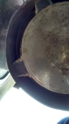

On the bottom of my Tee piece, I looked up into it, and that outer part as seen in my previous picture, that is an outer wall.
If you look at my picture posted here, that flat bottom is the bottom of the pipe where I can look up into it, but if you look, between outside edge, and inner pipe, there is a layer in the middle, which to me, says this is probably insulated.
That round bottom is the width of pipe the smoke goes in, I know cause I took that off and put a flash light up there, so mine has 3 layers of steel.

BTW, the guy who inspected the installation had zero problems with the chimney and passed the entire install with no problems at all.
