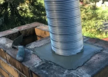

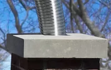

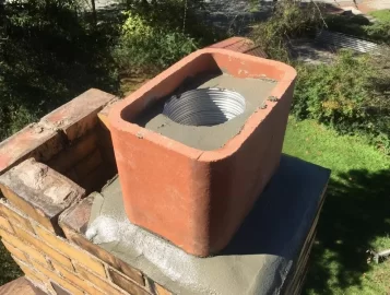

They cemented the top of the liner in?
Yes. Seems uncommon but I've seen it done before and advertised on other installer's websites online.
Here's a couple example photos of what I mean that I found online. Similar to this. I will post a picture when I go up there this week, but it looks like the first 2 specifically. They put cement/concrete/masonry between the terra cotta and liner.

So what is going to give when that liner heats up and expands? Something is going to have to give. That means either cracked masonry or kinked stainless. I can almost guarantee it will be cracked masonry. There is a reason no liner manufacturers instructions tell you to do it that way.
If it is a custom oval liner it needs a custom oval top plate.

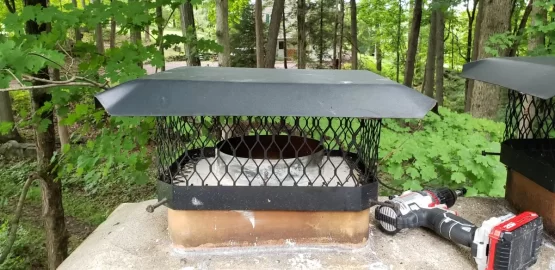

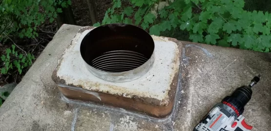

Finally got on the roof guys. Here are some photos.
Ran a super hot fire for around 8 hours the day before - the masonry "top plate" doesn't look cracked.
I think what helped is that the liner seems to end right below the masonry, and a more round end piece is attached at the end - maybe that doesn't expand and contract as much?
Regardless, I'll inspect it each year and fill any cracks I see over time.
Thanks all for helping me get this figured out.

That is a very unconventional install...I sure hope that doesn't come back to bite you later...
Reactions: bholler
They said it was a very unconventional Mason chimney sadly.
My 2 neighbors' homes were built by the same builder in the 70s and apparently another guy was told by an installer they couldn't even get a liner to work properly.
I've burnt a few fires in 80f weather and despite the heat got a nice draft going. I think it'll work out.
The chimney looks pretty conventional to me. They just apparently make up the way they want to do the install instead of following the instructions and ul listings.
