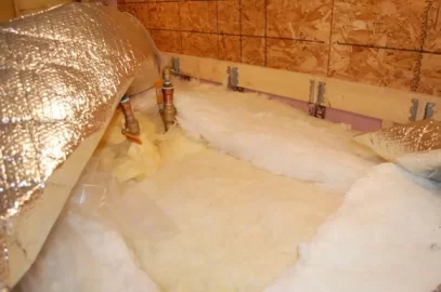

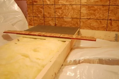

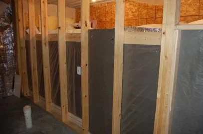

I have 8" of Poly iso under my tank, 20" of fiberglass around it and Capped with 1.2" poly iso and osb.
