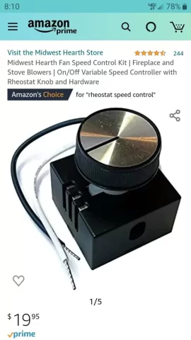

Something like this should work. You'll want to get a fan control. As long as it fits in the box it should work. Then it's a matter of whether you want infinite control or stepped speed settings.

I have ordered the part you recommended and it will be here on Sunday.
I received the part and installed it. It worked as advertised twice. Now it doesn't work at all. Not sure why. I bypassed the thermodisk and have the fan on high. The thermostat should control the fan turning on when it should. Pi can also unplug the unit if needed.
I installed this, (broken link removed to https://www.yescomusa.com/products/ehaust-duct-fan-speed-controller-120v-3-setting)
to get a lower fan speed and it works great on my Buck 91.
