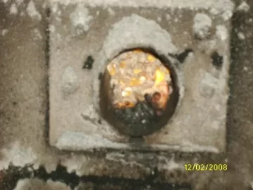

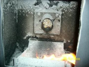

This is a furnace I have and I used some dirty corn just to see what would happen. The furnace will burn the corn but it heats up the auger drop shoot. When the fines come down the shoot they ignite and cause a clinker in the tube. This causes the corn or pellets to dam up and can start to burn.
I just wanted to show what happens with excessive fines in corn or pellets. Watch what you burn.

This was with a corn pellet mix. I had a farmer donate some of his corn to see how it burned. It was not sifted but burned well in this furnace and one other stove. It did have a large amount of dust and fines in the bag. I wear black shirts and when I lifted the bag up I was covered in dust from the corn.
I have not cleaned this furnace in some time (never) and kinda running a torture test on it. That is why I am not listing the name of the furnace but it is doing a very very very awesome job so far. My next test is putting in some scrap metal. I heard Magnesium burns hot....... It is all abouit the BTU. Kidding.

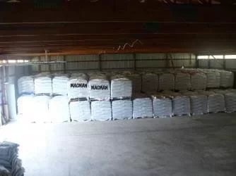

OK, after you've had a "few" beers, and when you DO decide to put the mag in the FURNACE, I'll make arrangements to rent the trailer to pick up the 2 tons of free pellets you have saved for me...........whadda mean you don't remember that???? have another beer, and then take a CLOSE look at the pic...you even marked them for me. :)
RIGHT.
I done some crazy things with beer but giving pellets away is not one of them. The warehouse is looking worse than that. After today I am down to 30 tons and 10 are paid for awaiting p/u. Next truck coming in for my supply is not till the 10th. I have a load going to a store I supply and it will break the 1,800 ton mark for the year. My kids like it empty so they can ride their bikes.

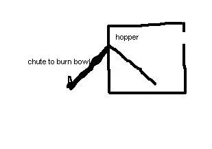

eric, have you ever seen a fire from this setup? love ms paint
I just sat her almost crying. I though of my kids and their crayons drawing the backyard swingset. "how did the dog get up there? Stop I do not want to know."
It would take a lot to get fire up the drop chute since the corn clinkered up, in this case. Now smoke will be a different case. In a case of pellets, I only burn quality pellets, MINE. I think it can be done but would need the moon to align with the stars of Jupiter while Venus dropped into an eclipse (you know what I mean).

Thats how a Quad works, auger pulls up from the bottom of the hopper then drops into a free fall chute down into the firepot. Hopper fires are very possible but only when the stove is left un-kept. If you let enough ash build up in the firepot eventually the raw fuel will start backing up into the drop chute. This would "bridge" the chain of pellets from the firepot up to the auger tube. From there you just need a few other variable to line up right and you can start your hopper on fire.

That is the way most stoves are except bottom feeders such as Harman.
Yes there will need to be a large pile of whatever to get the fire into the auger drop tube. It can be done but I think that the negative pressure in the stove and lack of combustion blower into the auger tube will keep the fire from happening. Pellets will not burn on their own and need the combustion blower.
