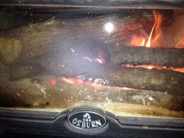

Here is a video of my Osburn 2400 open Draft vs closed Draft. Not very cold out so I only have half a load in there.

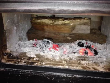

A picture would be much more efficient..I need a pen and paper to draw that one out. LOL.

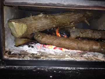

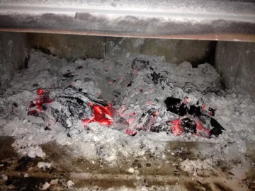

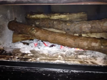

Here is a pretty close example from last night. I loaded the stove around 12:30. Notice the coals are raked forward and a valley is carved in the ashes in the center of the fire box floor. This allows air to flow under the splits from the front of the fire box to the back. The two large splits in the back are black walnut. The smaller rounds in the front are cedar and pine. The stove top temps topped out around 600.
Obviously I didn't fully load the fire box as the outside temps weren't super low, there was little to no wind and the house was already pretty warm. I reloaded this morning around 9:00 am. Stove top was 200 (same as the start temp). House was low 70s in the stove room and 66 in the bedrooms. Outside temps were mid twenties as a low over night and lower thirties when I reloaded in the morning.
I hope this is helpful, because for some reason this post took me forever to put together.

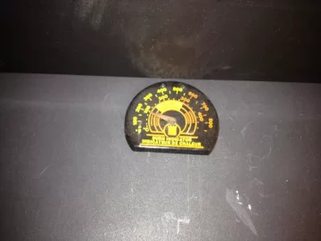

I have about 28 feet. On a cold day I can hear the draft , this morning 7 logs. Coals from night before 15 min 800 and I completely closed at 800. Door gasket looks fine. Just a big draft I guess
I think this morning quick heat up is due to high chimney and smaller splits. Also n/s load. Going to try the varying size in splits and the e/w load on next load up
