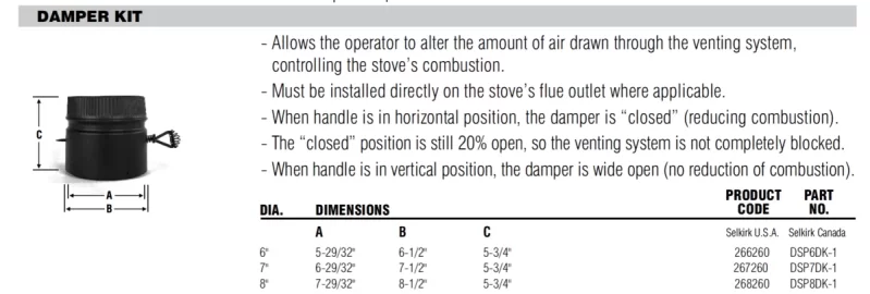

woodstovepro.com has it also northlineexpress.com
I don't know if hearth.com patronizes any certain web stores or not, don't wanna step on any toes
No problem. This is the part picture and part number.

A damper may resolve the issue, or a 90 elbow would help some. Both would be worth trying.
I am going to try a non-draft inducing cap first....then the damper may be thought about
