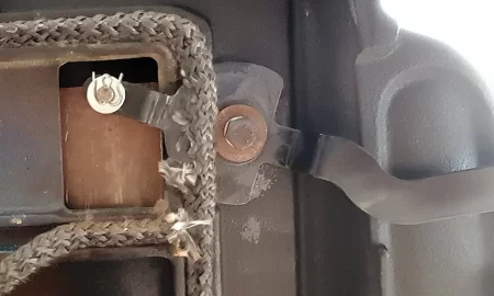

I just had my Hearthstone Heritage apart and can state that the air control lever even when moved all the way to the right only closes the air door about 80% to comply with EPA rules. You can see that in this picture with lever in a fully closed position. The sliding door popped out of the lever so I drilled a hole and added a cotter pin to prevent that from happening again.I suspect if you close it all the way the fire will snuff out. You don't want that. Everyone's setup and draft is slightly different. You will have to experiment a bit. Try closing it down 50% and see how it burns. If no change move it 75% closed and see how the fire responds. If the fire regains strength you may be able to close it all the way, or maybe not. On our stove I can not close it all the way until it gets cold outside.
