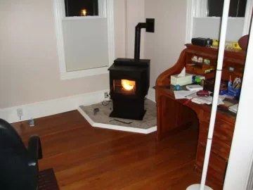

dukefan3916 said:This is my new P43 all fired up. I am looking at possibly getting an outside air kit for it. Any ideas or suggestions would be welcome
Simpsondukefan3916 said:What was the brand of the one you used
