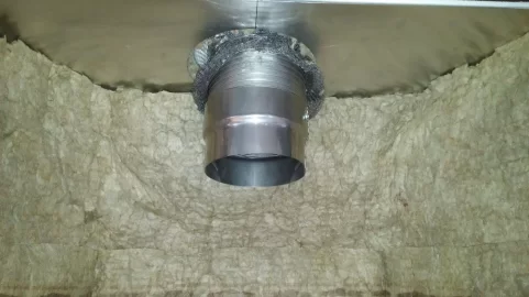

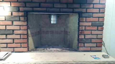

Every masonry fireplace I have seen is different because they are hand built. Some the dampers are pretty easy to reach and some not so much. In my fireplace the throat was cast iron and kind of far up so it was easier to mount the plate lower and screw into the mortar joints with tap cons.
