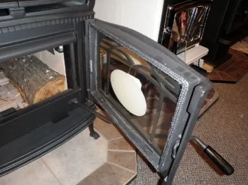

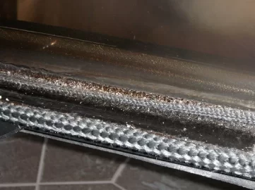

I also just notice that the glass is getting a little brownish looking around the bottom corners. Is this normal and if not what am I doing to cause this?

BeGreen said:The only thing that is important is that the gasket is making a good seal between the glass and the door. The rest is cosmetic.
