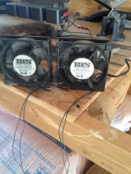

Do these little fans really push enough air through the ducting? I have a 1.2 but haven't installed it yet.

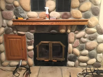

wow this looks EXACTLY like my fireplace set up but the previous owner took the doors off and hid them :)

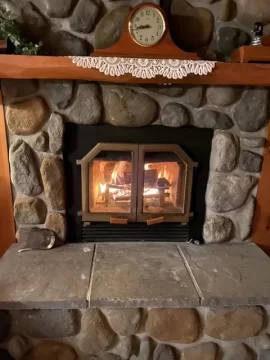

Here’s a pic of my 31 year old BIS (can’t find the rotate tool):
