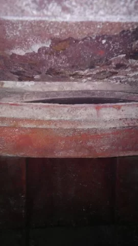

Actually I just looked again. There's a big gap. I'll show the pic, u can see where the piece makes a U shaped Dion and vent on top

Yes it deals very well as I can see. What would u recommend me doing with this?or going from here
contact harman send them pics and see if I am right about what it is. If I am see if you can get the parts to convert it. And if they will issue you a new tag. Until you find out those things you cant make a decision. But as is it will make a horrible wood stove.

Yeah that is what I thought it would look like. Contact harman see if they can id it and if you can get parts. As it is now I would say it is unusable.
The piece that is warped is pretty solid steel or iron. I can't see getting that unwarped without damaging integrity.
If I were to use this as a coal stove, would that warped piece still make it unusable or is it integral part of stove
No you wont it would need replaced.
I would have to look at it in person but that bypass is there for a reason and they way it is it does not work properly. And it will continue to warp more and more now.

On the front bottom panel there's a toggle for coal and wood. I spoke to my wife and she said previous owner told her that it wasn't warped ( piece inside) but because of your burning coal , you need an air gap for the gas, this sound right?
Not right that is warped without question. What does the wood/coal lever do?

The baffle you showed is integral. With the ability to burn coal...y our guess is a as good as mine why it warped. That stuff burns crazy hot in this stove.
This is an early cat stove that will burn wood or coal. The "cat"...if it's still there...looks like a piece of rock wool type material with 3/8" or holes in it. Maybe 6" x 8" or so if memory serves me correct.
The "Wood/Coal" lever switches the airflow from in the firebox (for wood)....to below the firebox "shaker" grate...which is used for coal. (or to knock ashes off a wood fire and rev it up. The ash pan is below the shaker grate in the door that opens. You keep this door shut because it controls the airflow for all burn modes.
Like many cat stoves...you fire it up....get it hot....and drop the bypass.....forcing the air through the cat. You do not burn this stove without closing the bypass.
