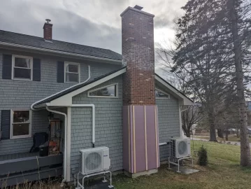

Imagine a 4x8sheet of rigid insulation board or pink board and some wood strapping held to the exterior of the chimney with screws. I will try to snap a photo of it tomorrow

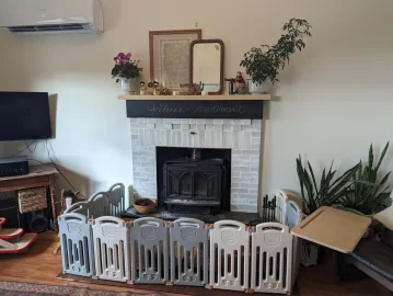

Inside and outside photos. Right now this is more of an experiment than anything to see how much warmer the fireplace will be on days where I'm not firing up the stove. If it makes a good difference, I'll probably leave the insulation up and put some real siding on it. However, if it really doesn't make much of a difference, then it's easy enough to pull down and plug small screw holes in the grout. So far I've been pretty impressed. Without the stove on the back of the fireplace is registering about 55 to 60°. Before it was measuring about 45°. It's pretty consistently been between upper 20s to mid 30s outside for the last several days.

Interesting. Then how can the house walls, as constructed, be in contact with the masonry?
They shouldn't be either. If they do your chimney doesn't meet code and should have an insulated liner. You can have trim touching the corners though. For an exterior chimney in the US you need 1" clearance to combustibles. But once you wrap. It it's no longer exterior and needs 2". Or zero with an insulated liner
Great. The previous owners must have had some yahoo install this liner. So I guess my options are replace the current liner with an insulated one, remove the liner and wrap it or pack vermiculite around the liner in place?
Pull and wrap the liner would be the most logical and cheapest as long as the liner is in good shape
