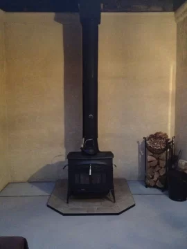

Well everything is done, stove looks new I even found the pipe shield for 8" pipe and the stove rear shield pretty inexpensive both for under $200 so I didn't build a wall heat shield. The only thing I had an issue with is the manual still said to have stove 19" from wall with heat shield ( I thought it could be closer like 12") and pipe could be as close as 12" with pipe heat shield... so that's what I did 19" for the back of the stove and it came out to 16" for the pipe, finished product see picture (wood on right is 27" away manual said 24" or more for the sides). I was told by the manufacture that I can have a fire with the front doors open if I wanted too sine I have 8" pipe all the way up but I will need to get the optional screen insert for the stove, sweet surprise I'm stoked.

Looks very nice! I see no fire !!!!
