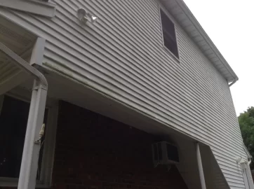

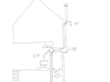

Do you guys think he can do something like this for the gutter section.
[Hearth.com] Help Please
Or no because of the tee
You can do that, but you will need sturdy extended brackets to reach that distance from the wall. Would be better than using the offset around the gutter.
With that, go with 2 -45 elbows inside rather than the 90s.
You may also need some kind of support under the T. Extended that far out is asking a lot for that T and the horizontal run to it to support.
Reactions: Backwoods Savage
