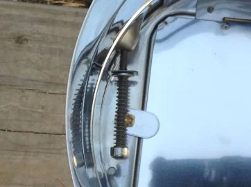

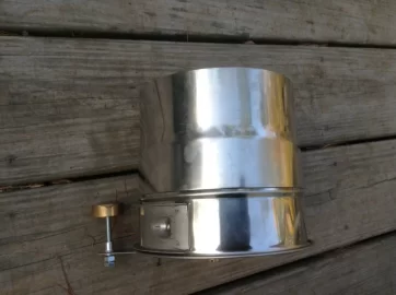

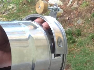

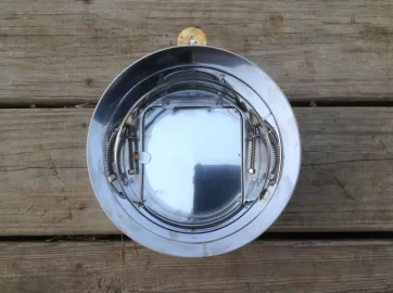

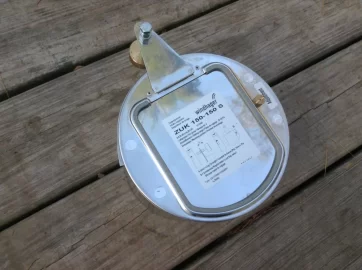

Some pictures of an explosion cover integrated in a barometric damper.
The reason the door blows open is because it's pressure on a flat surface.
If the door does not open, then the pressure will most likely act on the next weaker flat surface; boiler water jacket, .... .
