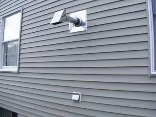

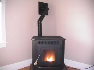

Here are pics of how I get 17,
Clean out T=5
2 -12" up= 1
45* elbow= 3
1 diagonal= 1
1 90* elbow= 5
2 -12" out= 2
Total =17

I vent through a window, its in a mill building so the walls are three feet thick and per my condo assoc I am not allowed to drill, so i must rise three feet to be above the bottom of the window sill. I might build a platform for the stove to sit on that will give some height and cut down on the lenght leading out side that might keep me under 17 evl and save me a couple hondred on a new thimble , pipe and elbows. Do you think my isuue after changing everything might be simply resistance??
Im gonna have to either shift to 4' or try to shorten my pipe (nevermind) some how. If im at 19.5 then its resistance!! Looks like another project!! Thank you very much. I wish I knew that formula before I bought a new blower and gaskets etc!! My own fault I didnt do enough research. Thank you again Fire honor society!! Graigslist.com ...6 feet of 3 inch pellet pipe for sale 2 elbows and an end cap hahahahah
