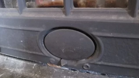

This is the lower air control
Anybody know what model Jotul this stove is? How do you work these air controls? What year was this stove manufactured?
F3?
[Hearth.com] Help Needed on Unknown Jotul
Yep F3. That isn't a lower air control. It is for startup air. Leave it open during a burn and you will burn too hot.
Manual available here. (broken link removed to http://jotul.com/us/products/stoves/_attachment/29766)
