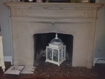

The hearth is a Tudor arch. From the front it is 35.5 inches wide and 29 inches tall at the sides. The peak in the middle is 32 inches high. Looking from a birds eye view the front is 35.5 inches wide. It is 21 inches deep. But it tapers to the back so the back is 26 inches wide. The hearth extends 15.5 inches so I will be extending that.

That fireplace is beautiful. I don't know what your budget is but I would go with a freestander in that space. I love my insert and I'm pretty sure it would heat your space pretty well but aesthetically I think a freestanding stove would be better. If you're looking for an insert on a budget I found the best prices on www.dynamitebuys.com. The Osburn 2400i was the best value for a large insert when I was looking two years ago. Either way good luck with it.

Also, what is the mantel assembly made out of? Is it entirely non-combustible or is there some wood in it?
The mantel is poured mortar I believe. I don't know if I have enough length front to back for the nc30. Can it be installed as an insert? My insurance doesn't go up for an insert.

Cool, it looked cast, but I had to ask.
How do you mean the front to back issue? What's important is how the flue outlet aligns with the liner. A slight angle might be able to be offset in the flex. If the hearth needs extending, that's possible.
i think it would need to be extended A LOT. The fireplace is 21 inches deep plus a 15 1/2 inch hearth = 36 1/2. isn't the englander about 30 inches deep? Can I install it without legs so that my insurance won't be raised?

the stove will have to have either the pedistal or legs attached as the intake opening of the stove is under the firebox so the unit will not sit flat. there are shorter legs which may make it easier to fit if its close to too tall but its gotta have somthing under the firebox.
31" deep, but part of that is the ash lip. The hearth needs to extend 16" in front of the glass, so maybe an 8" extension. That isn't a lot.
