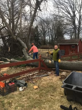

We did good this morning separating the top of the tree from the main log. My friend had the Stihl and got pinched so luckily my new bar and chain came in time and we used the second saw to free it. Once we got to the main log it was just slice and split. I sliced a few with my Husqy 435 with 18” bar and felt good doing it. We filled three pickup trucks worth and then had lunch with a product partner on annuities. He brought Chic Fil A and we were dusty. It was a great day. There is one truckload left. I’ll get next week.

Pictures of good teamwork and progress!!
