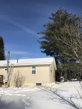

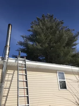

Lots of good suggestions above from guys with experience but I did want to ask if there are any trees or other roofs in close proximity to the stack that may be higher than the stack outlet. Is the stack at least 2 feet higher than the ridgepole of your house?

Quite possibly. Wind direction might also play a part but sometimes hard to predict as swirling and weird stuff like that also usually happens.
When the wind blows from in the direction where the tree would get hit First by the wind so in my instance from the west, the smoke from my chimney ends being pushed low to the ground, like 6 foot off the ground then it with eventually dimisimsh and you can’t see it anymore but I’m wondering if the tree is causing this.
Well just because I have the capability of cutting this tree down. It will be down next weekend and we will see that the verdict is.
Yes, they would have thast effect on the wind/draft. You could try a chimney cap to reduce down draft.
