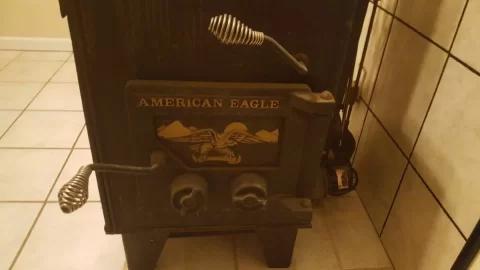

My father has had this stove since approximately 1985 or 1986 and never gave record to his town, which they require.
From what he remembers the make is Lancaster Fabricators from Buffalo, NY...which is now out of business. The model is American Eagle. This could be wrong. It was bought a long time ago, and he is old too lol.
He swears it is a zero clearance stove because the back and side of the stove stay cool, but obviously the town will not take him at his word.
I must submit specs to the town. Any help would be greatly appreciated. Thanks.
[Hearth.com] Help finding specs [Hearth.com] Help finding specs
With no ID tag /paperwork stating otherwise you have to follow NFPA rules.
