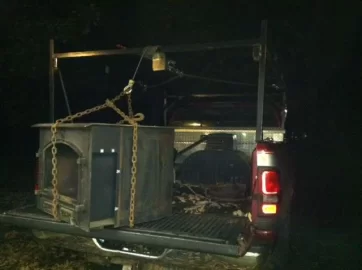

Delivered. Had some paint issues from a loose pieces rattling around on the trip.. Removed door and brick and used an appliance hand truck and ramps to get in front door

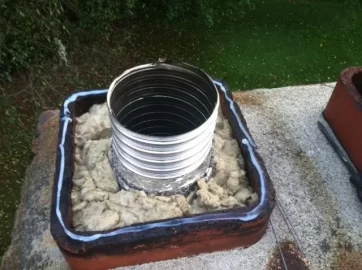

Chimney top. Added some roxul here as well before sealing up. Ended up with exactly 15' length liner. Fully insulated with block off and top ins. Should be a cosy liner

The block off plate was so close to the top of the stove (5") made it a LOT of work to connect the liner to the.. Worth it now with the full surround being rocked and insulated but a few choice words getting it all together. I think this will make a difference in heat retention and ultimately performance like you all said. PITA for sure! Left stove sticking out max for most heat transfer possible - heat is the priority over beauty. I did compromise with the boss and got the brushed nickel face to give it a prettier dress.... Happy wife worth $180!
