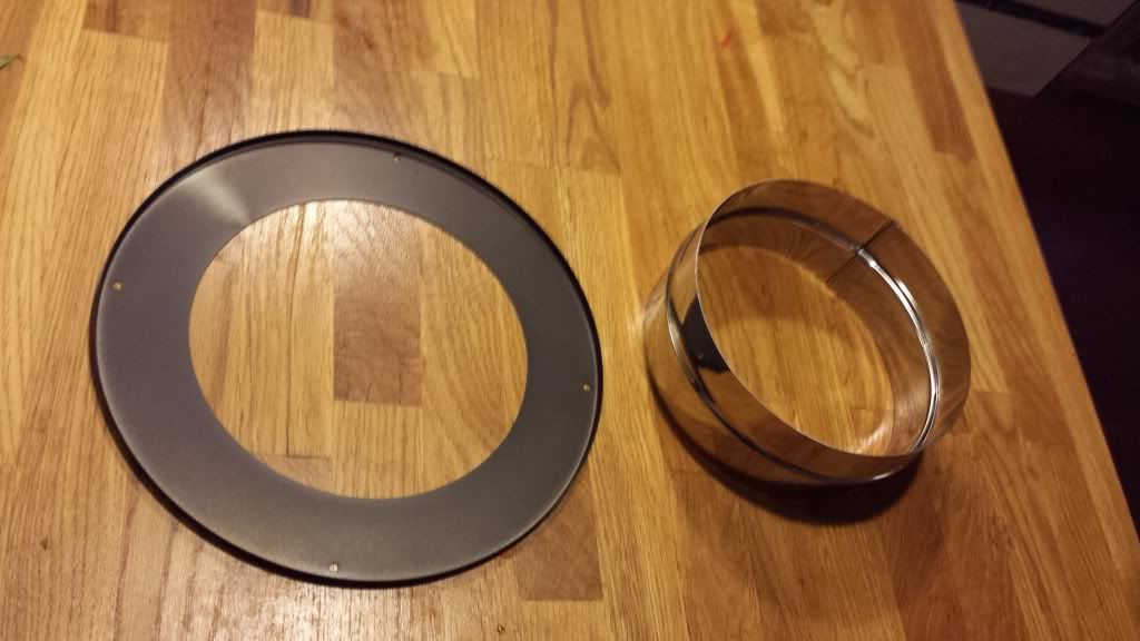

I have the dvl duratech support box and I believe they forgot to give me a part - adapter to connect black pipe to support box? I now have only three parts - chimney adapter to connect to the stove, telescoping dvl, and a 24" section of dvl...
I can't connect the black pipe to the support box without that adapter right?
Darn it.
It came with 6 screws... It seems pretty straightforward but I can't see where it explain how to connect it on the manual...
The SS adapter has one larger diameter side to it. The small side will point down, slip the trim piece over the adapter and Insert into the box. Then screw the trim onto the bottom of the ceiling box. The trim piece is pre-punched, I think it only has 4 holes.
Thanks webby!
Indeed it is preholes with 4 holes. So I just stick it in??? interesting. Then the DVL pipe snaps to it and then I put screws at the connection to hold it together?

Once I connect that adapter on the ceiling support box - the 24" pipe slides into it but then if I can't connect them with screws unless I punch the inside wall of the pipe.... Unless this adapter needs another adapter. Please help. If someone can pm me his number I'll be happy to call.. I'm really at a problem here
