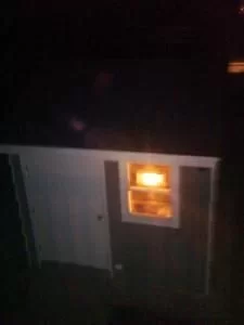

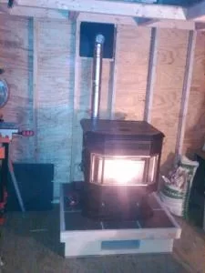

Even though you may only need 3" clearance on the side, I like to have enough room on each side so I can open the side panels for servicing. These stoves need service and the less times I have to disconnect the exhaust and OAK to do some maintenance the better!! So I do not like to put them in corners.
Even in my shed, I like to have room on each side! See pics

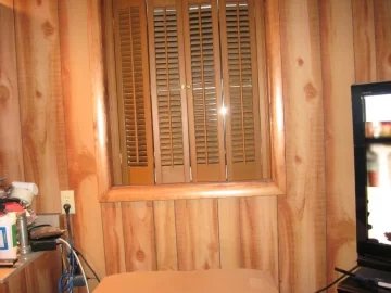

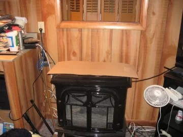

Okay lets try this picture thing.
I don't think this is going to work well.
Worked better than I thought.
The picture on the left is of the propane stove that I currently am using, you can see the counter on the left and the tv stand on the right, there is 49 inches between the 2 items.
The picture on the right is above the stove sorry it didn't go to the ceiling, the window is 47 inches from the floor and is 30 wide x 36 high and there is 7.5 inches to the drop ceiling .
Looking over the Harmon offerings the P38 looks like it is my best bet but I would need the sides, I am not sure how much that will add to the 22 inch width but my clearance would come down to 10" per side.
