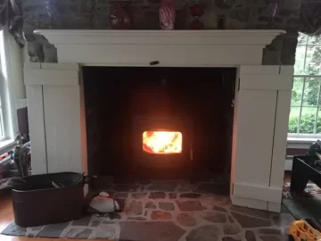

Ashford burning on high setting, just a few minutes ago. Enough flame show?
Yes, I'm burning in Philly... in June!

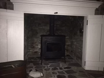

... And on low:
[Hearth.com] heating 1800 sq. ft
the high is sweet and I can't see anything on low. hows the look on medium? Whats the price of the ashford

There is flame show at medium... pretty much right down to the lowest range of settings. It's analog, you can run at any rate, not detented for specific hi-med-low settings.
I paid under $3k each, but I was buying multiples, so they were willing to play on price. I think list is closer to $3500.
