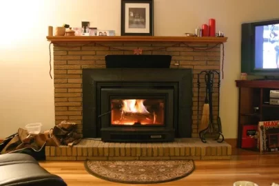

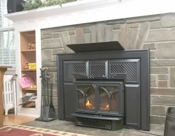

Here are two examples of mantleshields lifted from the photo section of this site. Note that they stick out and up to seemingly bop you in the forehead when lening in to blow on the embers as if to restart a dying fire.
  • [Hearth.com] Heat shields
Hibeam, thanks for posting those pics. I'll definately buy new crown molding and get my clearances where they need to be. I can't believe those two pics. Two beautiful stoves uglied up by a piece of metal. I was under the impression that the mantel shield was part of the stove and would look better than that.
The one on the right is a clydsedale so I thought would be most applicable to your question. In my opinion I would do almost anything to avoid one of those head bangers.
