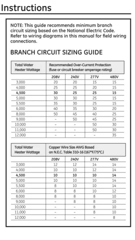

Ok, so it's a Rheem that was delivered at my brothers new house today. (I personally own the now discontinued GE heat pump HWH at my house). Today I open up the electrical connection box and see to my horror, #10 wire! Wait, isn't this supposed to be efficient? A 220 30 amp breaker to a domestic HWH? Whatever...mine draws less power and requires less power apparently with a 20 amp 220 feed. But wait again, does it draw more power over less time? My head is spinning and I have to re-run a larger wire and breaker to feed this beast. On demands require 90 amps BUT is more efficient as the time is only as demanded....technology run amok...way too smart for me little pea brain.....
I think the geospring has to be 10awg 30amp breaker also, thats how i ran mine.
It has to be able to handle the higest amp draw which is from the electric heating element, 4500w or so. Heat pump only mode is the energy saver at somewhere around 500w.
@Rearscreen, the heavy wire is so that it has enough amperage to run in conventional mode...where it uses the same kind of element as every other electric HWH. In HP mode, it uses far less amperage, and uses about half the electricity kWh per HW BTU delivered, relative to conventional or on-demand.

Geosprings instructions pretty much say 10awg also...
My error, just went to basement and it is #10 to 30 a 220 breaker. Thanks for keeping me on my toes cableman! I do recall swearing at GE by not giving me ANY room in the connection box....
