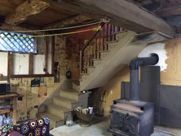

So I went to the store to choose the stove, and when the dealer saw the installation (the photo I posted earlier on), he stopped right there and explained to me everything that was wrong with it. The clearances, the single tube going trough the wall, the covering under the stairs, etc. And no, i didn't have it inspected yet. I'll do it. I'm a beginner, shall I repeat. We haven't signed yet, so that's good for us. But now, i'm pretty nervous, and moving in a month.
So, that's how my first date went, Swedishchef.
I'm posting the photo again so you can have a look.
[Hearth.com] Heat going up or not?
Yes, there are clearance and installation issues, that is true. A SS liner would be the best or a CLass A chimney with Tee and thimble. But you have a brick chimney right?
That being said, what is the distance from the back of the stove to the wall? If you had double wall stove pipe with 2 X 45s instead of 1 X 90, you may be able to get away with the clearances.

No, it's not a brick chimney, but a prefab beginning on the other side of the wall, in the wood chamber, going inside trough the first floor, and then outside for the second floor.
I think the back of the stove of clear, even more if I get a new one. What worries me is the tube going through the wall, and the back of the stairs, for what I know. But then again, I don't know much, and I haven't moved yet, so I can only look at the photo ;)
Anyway, I got an inspection for the end of the month. I'm wondering if I can require the current owner - who installed the chimney - to pay for the changes to make.
I think the cost is on you but what do I know. Anyways I would get the biggest stove that pleases the eye within your budget. Shop around.
You could easily put a PROPER heat shield on your staircase. That isn't a big deal. A new SS Class A Chimney would be in order. It could cost around $1200 depending on the height of the chimney but I think it would be well worth the investment.
