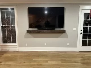

Set up: 1850 farmhouse remodeled in 2020. The house leaks like a sieve. Very drafty. 3,600 sqft. Living room install. Propane heat. Forced air that was roughly $4,500 a season to heat.
Motivation: Cut the heating bill down and make it warmer in the house. We live on 168 acres with prime hardwoods available.
Cost: Likely $14k all said and done.
Timeline: 3 months from purchase to install.
Install: Delays. The unit was broken delivered to the installer. The next one came and the adjustment foot broke at the casting. We agreed to install anyway. The installer stacked some washers to make the install happen. They will replace in spring. in retrospect the ceramic option looks awesome but adds cosmetic issues.
Install happened November 30th. I did a rear exit because of the TV and potential mantle. I thought a wonderful install. He was there 12 hours. First fire was flawless. One comment I’ve had was the the exhaust chimney was not properly supported but he he was legit. It looks good to me and those pipes are interlocking so unlikely a lot of stress on those connections.
Burn: I’m a 100 percent satisfied. This thing heats the whole house. We’ve only used 5 gallons of propane since. Unfortunately I may get charged a fee for not using enough propane. I think I’ll plan to bury my own tank to avoid his charge.
Hot: this this burns plenty hot. I love it. Once I have hot coals I can easily burn any wood no matter how wet.
Catalyst: mixed. I don’t really use the cat. UnLess I want to slow the burn. Overrated. I tell my family don’t use it because it’s finicky. I don’t engage it until it gets hot like way above the the half mark on the dial. I hope the government doesn’t try and tell me what to do because it’s likely I won’t.
I love LOVE the side loading door. It’s probably the best idea ever. Low smoke. Easy load. Quick. Less mess. The bottom ash try is okay. You have to remove the top grate so it actually works.
Typically after the stove gets hot I just load a log once an hour because it’s soooo hot if I fully load the firebox. Someone mentioned their Manchester makes charcoal and that’s 100% correct. Crazy. It bakes the wood into charcoal and once you fully open the flue in the morning it all burns off. Overnight burns I get 4 splits in there and it lasts from 10 pm until 4-5 am. Plenty of coals to just toss another chunk or two to get the fire going again. I can keep the drafty house house around 73-74 degrees unless it gets really cold and windy. I haven’t had temps below 18 degrees yet to find out what she’ll really do.
Negatives: minor but the ceramic colors do not match. It kinda like they paint the parts separately. There are chips. I only went the the brown to please the commodore. She wanted a pretty stove and it really is one of the best looking wood stoves I’ve seen. We LOVE the huge glass door. Gorgeous view of the fire.
