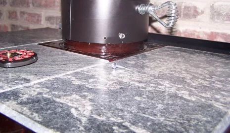

You're right, I don't need one; I plan on keeping it fully open. I only used it because it was another $30 for an adapter. I couldn't screw the elbow directly into the stove top (using the pre-drilled holes) and line everything up. The damper allowed me to twist to elbow to what ever position I needed.

I’m using the same damper (simpson) and no, it doesn’t fit like a glove. That’s why I didn’t use it until I installed the elbows.
It was a pain in the ass making sure the drill holes matched up with the holes in the stove collar.
I had to use #12, 3/4" sheet metal screws and it’s screwed in nice and tight to the collar. You can see in the pic where I drilled one hole too low :)

are those gonna be ok since they are not stainless steel?
Am I missing something here or is that not a dripless connection? i.e. are you risking having liquid creasote leaking all over the top of that pretty stove?
i think that may be a doubel wall dampner, so it would be dripless

I suggest replacing those screws with s.s. screws and maybe a lil "never seize" on the screws. Especially if you need to remove them.
I had a grade 5 hardened steel bolt that holds the upper protector plate in my insert corrode badly. I am replacing with s.s.
Good idea, I'll look for some online right now. :-)
