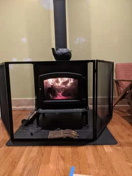

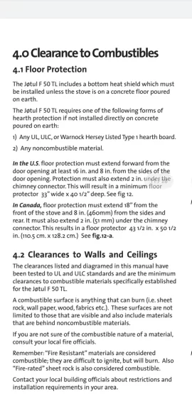

Well turns out that someone in my area had a Jotul F50tl in gently used condition. I pulled the trigger on it and have changed my mind on the stoves location. Looking at the manual's floor protection requirements (pictured below). It will be sitting on a hardwood floor so of course I will need a hearth pad. From what I gather, it appears (with the heat shield installed) it will only need to be ember protection? My plan would be to add a layer of cement board over the existing area hardwood floor and then lay a section of ceramic tile over that. Would that suffice and meet the requirements for this stove ?
