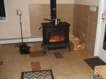

Ron
  • [Hearth.com] Harmon Oakwood Stove Temperatures Need Help!
Nice install,
What air settings do you run and what kind of wood do you mainly burn?? I have no clue and the dealer that bought it from will not return my calls. Awesome stove but dealers and support are not happening! Thanks guys for the input.
I burn mainly oak, what species I'm not sure, red oak I think and some pine, tree and scrap. With the damper closed and the air wide open I can't overheat the chimney, you see where the thermometer is. I have never had to, but there is an adjustment for the latch for the secondary damper could that possibly be leaking?
Thanks for the compliment.
Ron
