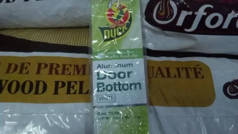

One thing I found when running my pellet stove, especially these past few nights where it has been really cold, is I can feel the cold air being sucked up out of my basement through the gap in the door to my basement (it doesn't sit flush with the floor and there's nothing on the bottom to stop air leakage.
I mean, I could really feel it being sucked upstairs under the door, like there was a fan on the other side blowing through. I plugged it up with a towel and I think it helped a little bit. I was amazed at how much cold air was being brought up into the living space.
My only concern is maybe the stove needs that air since otherwise my house is airtight. Didn't notice any difference in the burn though I guess.
![[Hearth.com] harmann xxv not heating house [Hearth.com] harmann xxv not heating house](https://www.hearth.com/talk/data/attachments/90/90731-bf5f9d02e05c9383a517d9d00f367f31.jpg?hash=kAfARlH3nh)
Much more efficient especially if your house is tight.
