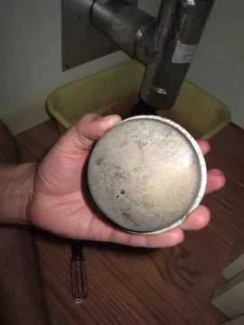

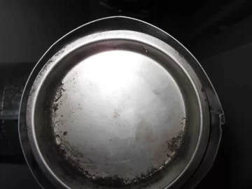

Completed a little more research tonight. Posted pictures below of the clean-out from the bottom with the cap in place, the cap its self, and the clean-out without the pipe in place. On the bottom of the last picture you can see where the fly ash goes all the way to the bottom of the pipe and is escaping.

Hmmmm...that doesn't look right to me. There should be a gasket or something between the cap and the T that will seal that when it is attached. You shouldn't have ash falling out like that.

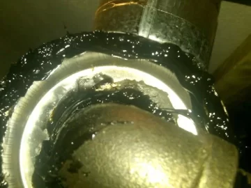

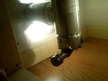

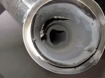

I got the Selkirk Pellet Vent Pipe Vacuum Clean Out Pipe and installed that. Without silicone it still leaked smoke on start up. I put a fair amount of silicone in the cap and around the top as you can see in the picture. The silicone isn't pretty but this is in a closet so I am not worried. It leaks out of one spot now which I can see. Once the stove cools I will put another glob of silicone in there to stop that leak. Like others I am not happy to be doing this myself but the hassle of having the installer out constantly to work on this wasn't worth the cost of the part. Along with the great advice from you fine folks we are managing well.
