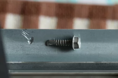

I got my Harmon XXV in Spring 2018. When I used it I would get noise. Thought it was Distribution Blower (Have new one sitting). When we removed it found 2 screws rubbing on frame of blower. Could not figure it out without removing blower. It's tons quieter now.

My Harmon XXV had couple of screws impacting the Blower. Would make strange noises. I ordered new blower and saw this when we went to swap it out. Been running without annoying buzz and strange noise since 2018. We went ahead and put High Temp silicon on anything that would have metal to metal to quiet it down too. Only way to figure it out was pull it out of unit
