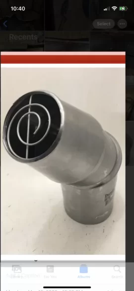

Hello
I would suggest an exhaust cap like this?
It can be straight out or 90 or anywhere in between. You can also turn it to face it so the wind does not blow into it. Maybe worth a try. :)

Hello
I use a 45* elbow as my end cap for the P43. It is angled slightly away from the wind. But, the exhaust is such a short run the flapper will still move during really windy days (if the stove isn't running). Not sure if that has more of an angle to it, but at the very least, it should reduce the frequency compared to just a straight end cap. Nice that it has built in critter control.
