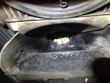

Question about Harman Accentra insert Ignitor:
I've noticed that after my "Ignitor" switch lights up (red ligh), it takes a long time (5-10mins) before I actially see sparks and the pellets lighting up.
Is that normal? Or sign of any trouble with the ignitor?
Its a new stove - barely 2months.
Does your burn pot look like mine with the holes on the sides?
[Hearth.com] Harman Ignitor
I have the same problem with long ignite times even after I clean it. I figured it was just the nature of this stove. I was told by the dealer and a Harman tech that it's caused by those extra holes. This style pot has been redesigned and Harman is replacing them at no cost.
