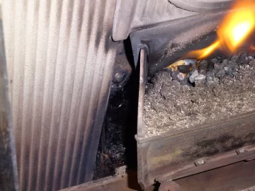

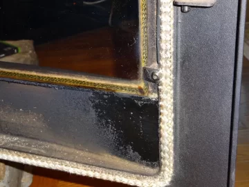

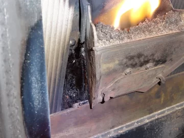

I have a Harman Accentra insert (Dec 2003 Model year). I bought it used prior to last winter and used it to heat my home all winter. I performed a full cleaning at least once a month and am very familiar with this model stove as both my parents and grandparents have the same thing.
Last spring I noticed a creosote building on the inside of the door and also on the left side of the burn pot. You could notice flame shooting out the side of the burn pot, appearing to escape under the flame guide.
I had a service tech recently take a look at the stove. He performed a full cleaning and recommended that I replace the flame guide which I guide.
I ran the stove for 3 hrs this morning on high and the black sticky creosote is back. It is evident on the side of the burn pot and also on the auger.
Any help or recommendations is much appreciated. I want to have the stove ready to go before the real cold sets in and I am out of idea's.
I've checked the door seals using the dollar bill trick and they seem to be in good shape. Not sure about the glass seal. Also not sure if the burn pot has some sort of defect or has cracked.
BTW - I am running New England Hardwood pellets.
Thanks
Dan
