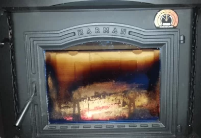

@NewHarmanOwner: Are you sure we are talking about the same stove? 14 hrs seems a little long for a 2.3 cubic foot firebox, non-catalytic. The HI-300 only has a single air-control rod, no damper control (although maybe you had one installed separately in your flue? If so, is that the secret to your extraordinary burn times?), and no "notches". Your description of the operation sounds more like a catalytic unit of some kind.
Absolutely, here is a picture of mine. I stuff it pretty full and my airflow is about one notch maybe 1 1/2. I set it at around 10PM and I won't have to reload and still have coal at noon. Of course, I'm burning oak slab wood, very dry and dense.

The OP has a Hampton HI300 insert not a Harman 300I. The model numbers are close but the inserts are quite different.
