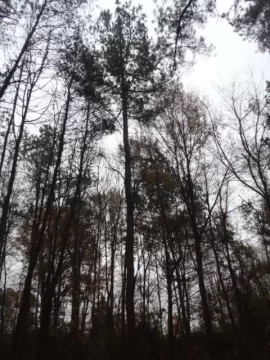

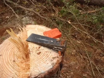

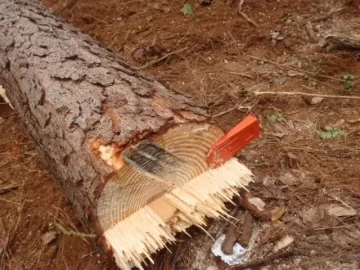

I am working on clearing a section of land for a pole barn. The tall pine in the center of the picture needs to come down. I want it to fall to the camera. I cut my face cut, then my back cut. I stopped to check everything before I went all the way. It looked good but when I got ready to make the final inch the saw was pinched. The tree had leaned back and closed up the back cut. It kept leaning more and more that direction. I really didn't want it to fall that way. I have never used wedges to control the direction that a tree falls and I was doubtful that they could straighten a tree leaning this far. If the wedges did not work my options were let it fall the direction that it wanted or try to push it with my loader and I didn't want to do that for fear that it would fall on me. I had one of the plastic wedges and one of the big splitting wedges with me. The plastic one went in about half way and broke off so I hammered the big splitting wedge in half way and then went back to the house and got another plastic one. I drove them both in all the way and sure enough the tree slowly leaned back the correct direction and then fell right where it should have. I was really impressed.

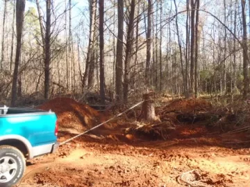

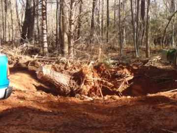

The two pictures with the wedges in them were right after the tree fell and they have not been moved. That shows how how much it took to correct the lean. The stump had to be removed next and I had to really put out to get it to let go. Pine stumps usually come up with out much trouble. I had to dig all the way around it and then once I got it out my loader could not pick it up so it will have to stay there for a while until I figure out what to do with it.
