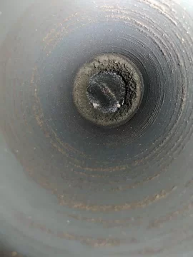

Took my pipe off again to show you what was in there.
First photo is looking up the pipe. The build up isn't an inch it's maybe a 1/4 to 1/2" at most. I don't have a brush yet(not burning until I sweep it), I just used a broom handle to k one it off.
Like I said, I can rub my hand in there and make it all shiny again.

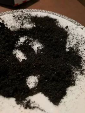

The 2nd photo is what knocked off out of the pipe

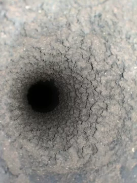

Looking down the chimeny at the soft stuff that falls off

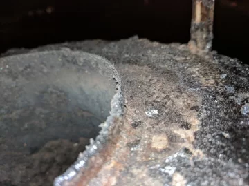

The build up on the rain cap.
Also just under the cap outside the chimeny looks like actually sticky Unhardened tar, stained my fingers.
