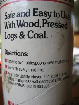

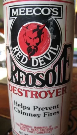

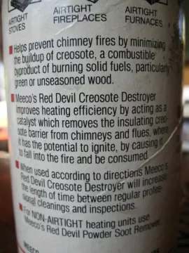

how about this stuff we put in our firplace once in a while its a powder called MEECOS RED DEVIL cREOSOTE DESTROYER.. heres some pictures of the labels and claims. are most these things snake oils?

greythorn, never heard of that specific product but based on the directions it sounds similar to ACS. It's a chemical catalyst which changes glazed creosote into a more brushable form. It's no substitute for brushing, but it makes brushing easier. Remember too that you shouldn't need it with an EPA stove as they burn clean already.

i use one of those csl logs for the last fire in the spring. it turns the tar like creosote into flakes. if the creosote was thick in certain spots it will fall on it's own, but generally speaking if you don't brush it stays put. if you are running a epa stove and you have a creosote build up, you are doing something major league wrong. those csl logs work alot better than sprinkling the powder on a fire. but anyway the cls logs are made for a slow burning fireplace or non epa stove. the csl log used in a stove that has a secondary burner makes any little bit of creosote look different from the flakes that it make in a non epa stove. in the stove with a secondary burner it turn the creosote into a fine black powder. like baking flour. you want to talk about making it easy to brush.
we a big back and forth thread on the csl log a few years ago here. were due for another.
the what was said is that the logs make chimney fires. they right to a certain extent. if you use the log or the powder along with your normal fires it starts drying the tar creosote up and when it get to a certain amount of times hot cold hot cold it start making flakes stick off the walls of the liner and makes it easier to start a chimney fire because the fire can get both sides of the creosote and makes for a quicker start. if your setup makes creosote it's best not to use the powders or log until the last fire. i'm talking my experience here. every time i used the powder i had a fire in the chimney start. lucky enough i there when it starts and i close things up and it goes out before i gets big and uncontrolled. anyway i'm beatin a dead horse here. if you use a log it will make for a easier brushing, but DON'T FORGET TO BRUSH.
