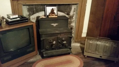

this is my first post here. I grew up with wood stoves. Haven't had one for years but feel reasonably comfortable with them. We recently purchased an old home. It's large and awesome, and the two central heat and air units only keep it warm at great pain (and cost).
My grandmother(possibly the most wonderful, interesting, generous, hardworking woman to walk the earth) has offered to give me her old wood burning stove. I believe it's a huntsman 400DD six draft. It's big. I burnt the hell out of my hand on it when I was a kid. It'll be a heck of a job just getting it out of her house and into mine. No telling what it weighs.
My real question is: is this the right fit for us?
- it's old, in great shape, but probably hasn't been serviced more than cleaning in years
- it's gonna take up a lot of room, and I'll have to put in heat resistant flooring/walls and a chimney.
- how much penatration of heat will I get through out my house. it's basically all one level, the room I'd like to put it in, the largest room in the house (so, even at full blast I think we could be in the room with it), where we spend the most time, is at one end almost detached from the rest of the house. Another possibility is the other end of the house where there is a capped off fire place. The chimney was capped when the roof was replaced. There's a large brick area in the floor it would probably sit on and the stack could probably be run up the old chimney with about as much work as cutting through the roof anywhere else. The house is kind of an "L" shape.
- it's old, and has probably lost some of its original efficiency, and wouldn't be as efficient as the newer models even if it were brand new. Can I upgrade it to increase efficiency ? Maybe seal it well/better? Get one of those catalytic inserts I read about? Other ideas? Are these ideas ridiculous?
- what else haven't I thought of?
Sorry for the wordiness. Just like being thorough.
Any help is appreciated
![Gift or headache? Gift or headache?](https://www.hearth.com/talk/data/attachments/148/148049-1d8d0c74309ff532f29eb632244ff030.jpg)
