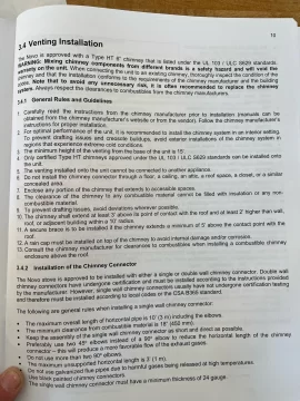

Hi, new to the site and seeking advice.
My family and I live in MT and just embarked on replacing our wood burning stove as well as demoing our CMU chimney and replacing it with a stove pipe for the stove.
All work was done professionally and I’m seeking advice on why my family is getting smoked out of our house. The stove is a supreme novo 24 and has about a 3’ rise before it 90s to a thimble and then up the backside of the garage to the top of the second story. The Wood that we used for burning is seasoned and we have tried everything from cracking windows to get fire started to relief any negative pressure, to opening door ultra slow when fire is good and hot.
We had the vendor out today and he wants to help make it right but we still have an expensive stove and pipe that smokes us out. Is this just the physics of having a stove above grade in the basement? Or is this because of the 90 degree turn? Or is it a stove issue? Long time user of wood burning fire places.
Note that the garage side of the stove pipe is framed in and insulated and the exposed pipe along the exterior of the house will soon have a chimney chase.
Thank you for any help you can provide.
