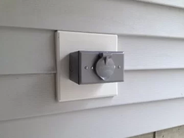

Why over-think the extension cord?
A simple 3 or 4 outlet extension cord will do the trick and no learning curve for the family!

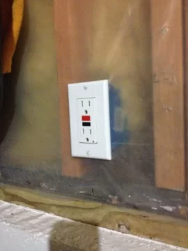

Outside: 120V NEMA 5-15P Inlet (3-Prong):
[Hearth.com] Generator to run pellet stove advice needed
Inside: 120V, 15A GFCI Outlet
Just a wall pass-thru. No cords run through open doors or windows. NOT connected to electrical panel (stand-alone). Easy...
rickhorn, Clever!
consider that GFCI won't work properly without some path to earth ground, a groundiing rod at that location may be advised.

Yeah ya know I really didn't think of that - I only used a GFI because of basement code, guess a standard duplex would have been just fine since the breaker on the Honda will trip anyway if there is an issue. I'll think about that...
I am an electrician for over 25 years and that is all you need, a simple pass through. Remember all you need this for is when the power goes out and you don't want to run an extension cord through a window or door. Keep it simple.
